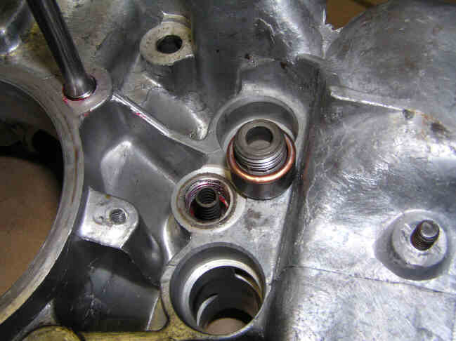

The small one goes between the lifter bores on cylinder # 1.

DNHunt   Oil pressure relief pistons. I test fit them and t...   Jul 20 2005, 07:24 AM
DNHunt   The large one goes on the right side front on the ...   Jul 20 2005, 07:56 AM
DNHunt   I found this old square from my dad and I used it ...   Jul 20 2005, 07:59 AM
DNHunt   The small one goes between the lifter bores on cyl...   Jul 20 2005, 08:00 AM
