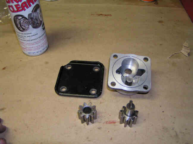

Here's a type 1 oil pump that's ready to go.

DNHunt   Here's a type 1 oil pump that's ready to g...   Jul 20 2005, 08:02 AM
DNHunt   Nice and clean and packed with a little grease   Jul 20 2005, 08:04 AM
