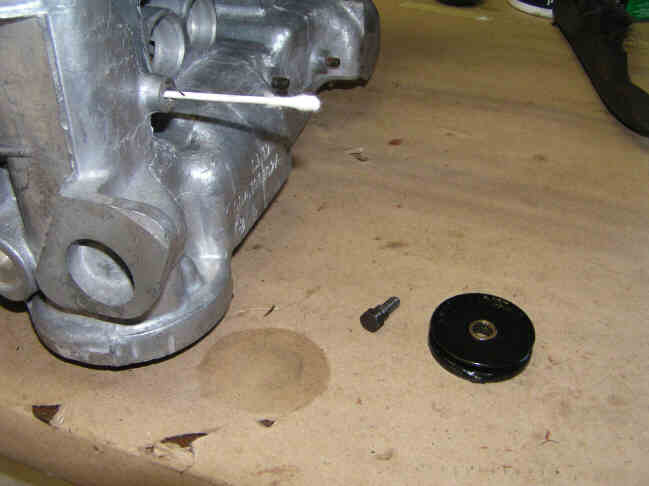

post Jul 21 2005, 06:00 PM
914 Wizard? No way. I got too much to learn.
Posts: 4,099
Joined: 21-April 03
From: Gig Harbor, WA
Member No.: 598
Still making progress. Here's something that's easy to overlook. Thermostat cable pulley. It goes where the Q-tip is.
