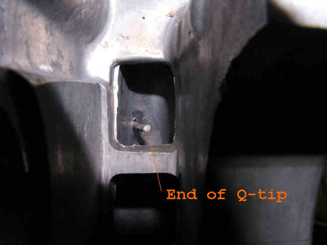

Here's the other end of the Q-tip from the inside of the case. Can you say oil leak?
