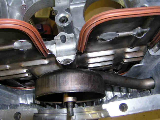

Here's the windage tray and the oil pick up in the left side of the engine. There is an O ring on the oil pickup tube that needed for the oil pump to suction oil from the sump. I use a little bit of Gasket Maker on the ends of the windage tray seals cause they always want to come off the tray. That tacks them down a little.

DNHunt   Here's the windage tray and the oil pick up in...   Jul 21 2005, 06:09 PM
rdauenhauer   So you not going with a Tuna can or Deep sump?   Jul 21 2005, 06:11 PM
DNHunt   I'm trying to show that you have to catch a ri...   Jul 21 2005, 06:13 PM
