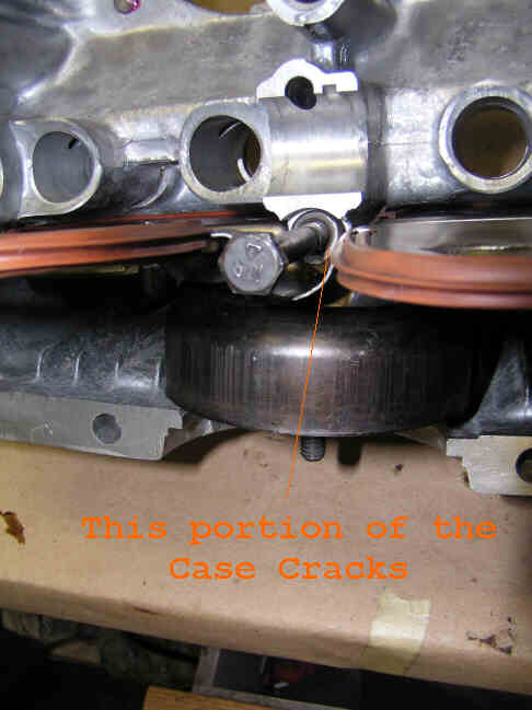

I'm trying to show that you have to catch a ring on the top of the oil pickup with on of the case bolts. I left the windage tray bolt to the oil pick up slightly loose to make this a little easier.
The part of the case the line goes to is the boss that breaks if you over tighten the stainer.

DNHunt   I'm trying to show that you have to catch a ri...   Jul 21 2005, 06:13 PM

Dead Air     Jul 21 2005, 07:29 PM
Dead Air   "I'm trying to show that you have to catch a r...   Jul 21 2005, 07:34 PM
DNHunt     Jul 23 2005, 08:35 AM
V6914   http://www.914world.com/bbs2/h...   Jul 23 2005, 07:37 PM
DNHunt   You guys are both right. A new washer and new bolt...   Jul 23 2005, 08:00 PM
