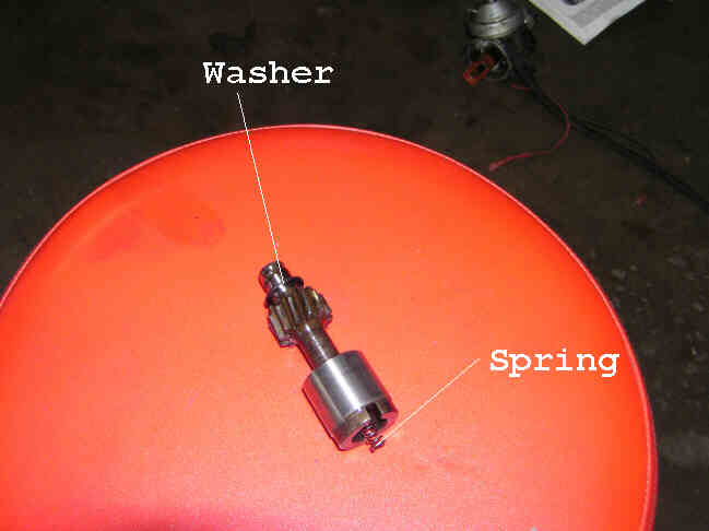

Rich, No deep sump or tuna can.
Here's the distributor drive with the thrust washer and spring. I think most people put this in before putting the case together. I aligned the notch in the dist body with the rotor and put the drive on the shaft. Then in it goes and I put the nut on the bracket
