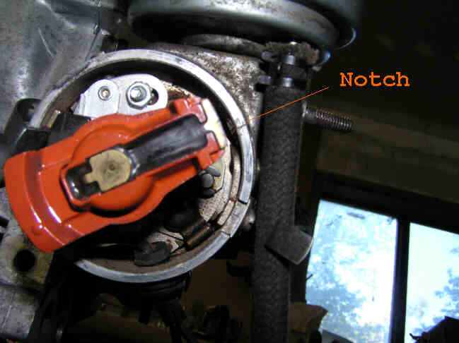

Here it is in the case half and nutted down. I have a crankfire ignition so I just run a dummy distributor but, it is nice for finding TDC.
