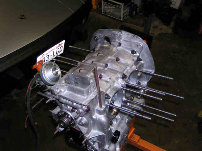

I already posted pics of the crank and cam aligned. I put in the cam plug, put on sealants and dropped the left half on. Put in the oil pump and torqued everything down.
Here's the lower end. The crank turns smooth as can be.
Dave
