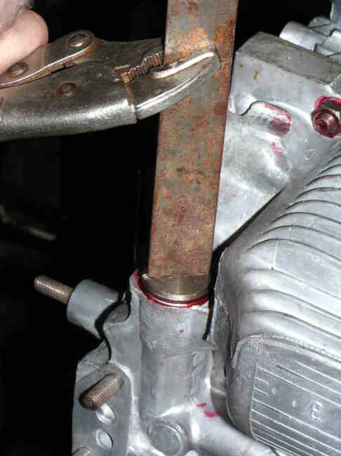

QUOTE (Dave Eddy @ Jul 21 2005, 05:29 PM)
QUOTE (DNHunt @ Jul 20 2005, 05:59 AM)
I found this old square from my dad and I used it with vice grips to tighten it. It fit the slot very well. Then a couple of taps with a mallet and chisel and it was seated real well
[QUOTE]
Sqare? (IMG:http://www.914world.com/bbs2/html/emoticons/confused24.gif)
Why am I sooo confused?
Dave
Here's what I was doing. my dad's old tool just fit a difficult place. That's all

DNHunt   Oil pressure relief pistons. I test fit them and t...   Jul 20 2005, 07:24 AM
DNHunt   The large one goes on the right side front on the ...   Jul 20 2005, 07:56 AM
DNHunt   I found this old square from my dad and I used it ...   Jul 20 2005, 07:59 AM
DNHunt   The small one goes between the lifter bores on cyl...   Jul 20 2005, 08:00 AM
