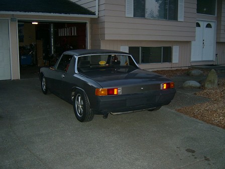

I drove Skline's car home, the big 1300 mile trip in a 914-4 2.0 FI........And that was enough for me. I pushed the car into the garage and sold the engine, FI, Tires, wheels and a few other 4cyl related items. (IMG:http://www.914world.com/bbs2/html/emoticons/biggrin.gif) Here is a couple of shots of the progress of Scott's old car. There has been a lot done to it you will not see. I just snapped some shots last night to give a quick update on this project. So please excuse the mess around the car. I have also been working on A LOT of customer cars lately. (IMG:http://www.914world.com/bbs2/html/emoticons/wink.gif)

Onto the car! (IMG:http://www.914world.com/bbs2/html/emoticons/boldblue.gif) It's done! Well, just a couple little things to sort out, but I drove it last night for the first time since it was a 4cyl.
HOLY MOTHER OF TORQUE LORDS! (IMG:http://www.914world.com/bbs2/html/emoticons/ohmy.gif) (IMG:http://www.914world.com/bbs2/html/emoticons/laugh.gif)
2.7's with carbs ROCK! (IMG:http://www.914world.com/bbs2/html/emoticons/happy11.gif) (IMG:http://www.914world.com/bbs2/html/emoticons/driving.gif)

Root_Werks   Painted it last night, all done! Just got to ...   Jul 20 2005, 07:59 AM
Root_Werks   Turned out better than I thought it would.   Jul 20 2005, 08:00 AM
Root_Werks   I used a rather slow reducer so the paint continue...   Jul 20 2005, 08:02 AM
