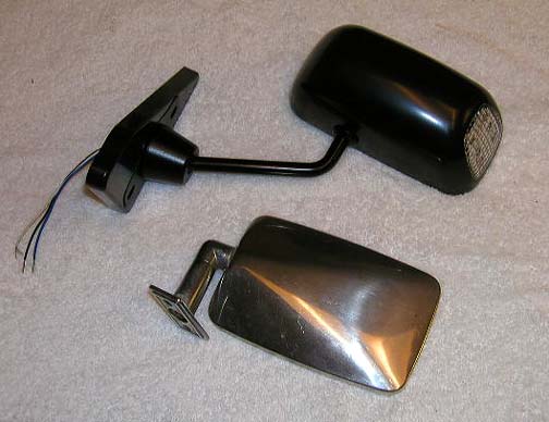

QUOTE (Neo914-6 @ Jul 22 2005, 07:25 AM)
QUOTE (Jeroen @ Jul 21 2005, 11:50 PM)
Hate to ask, but...
what are you gonna use for indicators?
why don't you mount them in the headlight buckets and use a flush mounted piece of lexan instead of the stock headlight door
I answered both of those questions...
1. mount indicators at Euro running lights, add mirror lights (they are like SPA copies)
2. My Boxster radiators will take up that room and covered lights don't have a modern look IMHO
Here are my mirrors/additional indicators...
The shape is not too "aero" or rounded. The mount will also serve as the corner filler where the front rail "can" be mounted on the door. There is method to the madness....
