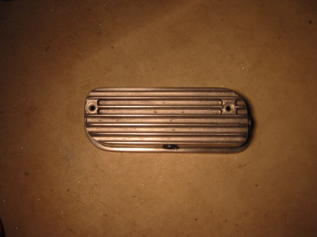

Jaiden   Here are the pics   Aug 8 2005, 05:48 AM
Jaiden   The inside pic. You can see the second port. SHo...   Aug 8 2005, 05:49 AM
Jaiden   Anyone?   Aug 8 2005, 09:08 AM
redshift   I would swaP in a stock set. Of course, I fix my ...   Aug 8 2005, 09:12 AM
Dave_Darling   I agree with Miles--swap in a stock set. (Agree w...   Aug 8 2005, 09:16 AM
redshift   It washes off, best to use Pam no-stick before agr...   Aug 8 2005, 09:20 AM
SGB   I gotta agree that it looks like a scary attachmen...   Aug 8 2005, 09:20 AM
redshift   The ones I have seen, needed machining to get them...   Aug 8 2005, 09:30 AM
Jaiden   Guys all humour aside I really need to get these c...   Aug 8 2005, 09:30 AM
SirAndy     Aug 8 2005, 10:11 AM
SLITS   You are already vented (supposedly) thru the oil f...   Aug 8 2005, 10:13 AM
Jaiden   Thanks for the offer Slits I really appreciate it....   Aug 8 2005, 10:23 AM
SLITS   I don't.....that way I wouldn't charge you...   Aug 8 2005, 11:16 AM
SGB   I plugged those vents with a stub of hose and some...   Aug 8 2005, 12:03 PM
redshift     Aug 8 2005, 12:10 PM
Mueller   I'll give you $20 for those aluminum cove...   Aug 8 2005, 01:44 PM
Jaiden   I had an Idea last night that I think will solve a...   Aug 9 2005, 06:47 AM
Jaiden   All cleaned up with Gromets installed.   Aug 10 2005, 07:11 AM
Jaiden   Another   Aug 10 2005, 07:12 AM
