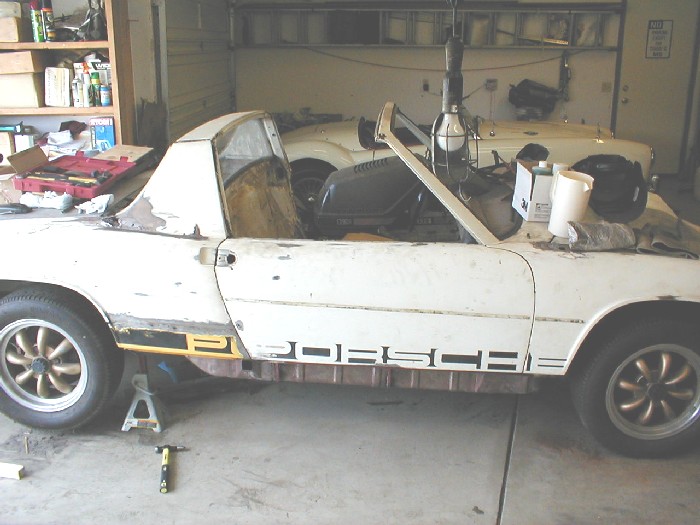

So I figure I better start contributing with some real content rather than stupid jokes and snide remarks. So here goes.
I purchased my 1973 1.7L for $300.00. Damn good thing to because there was about 8 thousand times the rust that I could see (IMG:http://www.914world.com/bbs2/html/emoticons/dry.gif) (duh!)
Before I tore the car apart I got the engine running. PO said fuel pump was bad. Turned out the relay was bad and in his attempts to fix the problem he reversed the fuel lines. Put a new relay fired right up...ran like crap but still it ran. (IMG:http://www.914world.com/bbs2/html/emoticons/biggrin.gif)
After stripping all interior, electrical and accesories from the car the real work started. Nothing more than expected just a long list.
Some of the problem area identified.
1) Rust in longs
2) Rear trunk and valance panel totally rusted out
3) Floorboards very rusted out - quite a few holes
4) Sill plates and door jams very questionable
5) Typical battery tray and engine shelf damage
6) Front trunk rusted around AC unit
7) Sail panels - bad PO repair with Bondo
Just one note for the rest of this, I am not CptTripps... these pic's are over a years time span. The reason I am finally posting all this is to motivate me to get 'er done.
It may not be realistic but I am still shooting for the FFC this year. I really have to get moving NOW!
