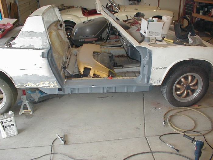

Just some rattle can primer to protect the bare spots.
Also first coats of All Metal filler going on.

tdgray   Finished Welding... still a little clean up to do ...   Aug 10 2005, 10:01 AM
tdgray   Other side... rust was not as bad. Less patching t...   Aug 10 2005, 10:02 AM
tdgray   Stripped Down. Doors and targa off now that I trus...   Aug 10 2005, 10:04 AM
tdgray   Door jamb carnage. Also firewall damage along with...   Aug 10 2005, 10:05 AM
tdgray   Cut the door jamb out. Normally you would pull the...   Aug 10 2005, 10:07 AM
tdgray   Firewall and inner fender repairs... no making fun...   Aug 10 2005, 10:08 AM
tdgray   New door jambs. I test fit these suckers about a m...   Aug 10 2005, 10:10 AM
tdgray   Next new door sills. Pretty easy installation.   Aug 10 2005, 10:12 AM
