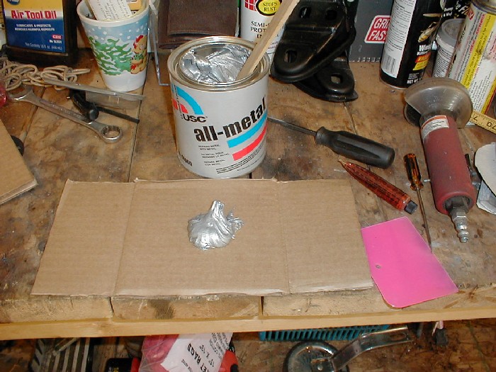

For those of you that do not know what All Metal is... well here it is.
It is a alluminum based filler. Totally waterproof, does not shrink, sands smooth and cures fast.
