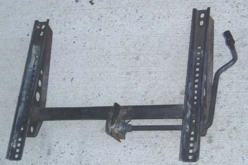

OK, I have a question about the driver's seat mount. It appears to have a rake adjustment, allowing the front of the seat to be tilted. I have the seat mount out, and it appears to be missing a piece.

zymurgist   OK, I have a question about the driver's seat ...   Aug 11 2005, 05:11 AM
zymurgist   Here's a closeup of the area in question. It ...   Aug 11 2005, 05:13 AM
tat2dphreak   yea, there should be a little hook looking thing t...   Aug 11 2005, 09:40 AM

zymurgist   The hook is there... it appears to have been retai...   Aug 11 2005, 01:46 PM
