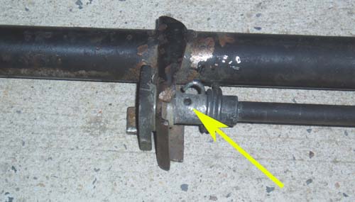

Here's a closeup of the area in question. It appears that there should be a bolt or a pin or something that goes all the way through the tube, and the spring hooks around it to provide tension. Can I just run a high strength bolt through the hole (see yellow arrow) and hook the spring around it?
