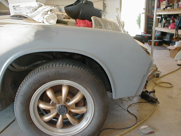

tdgray   Test fitting donor lower fender. Original was abso...   Aug 10 2005, 10:13 AM
tdgray   New fender welded in... major finishing to do.   Aug 10 2005, 10:15 AM

tdgray   Here is final fitting before finish welding. Fende...   Sep 6 2005, 07:12 PM
tdgray   All welded up (hah.. I forgot to take pics so you ...   Sep 6 2005, 07:14 PM
