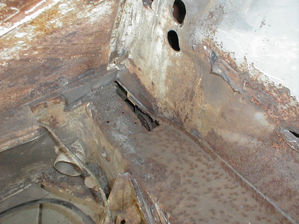

Typical battery tray rust.
I had already cut ( in a previous work session) most of what remained of the engine shelf out.
This is the "other half" of the rust I encountered when replacing the door jambs and sill plates.
Time to make with my crappy welding skills (IMG:http://www.914world.com/bbs2/html/emoticons/dry.gif)

tdgray   Typical battery tray rust. I had already cut ( in...   Aug 17 2005, 06:33 PM
tdgray   Other nastyness from this side. Amazingly the oth...   Aug 17 2005, 06:35 PM
tdgray   Fabricated and started welding in patch... and no ...   Aug 17 2005, 06:41 PM
