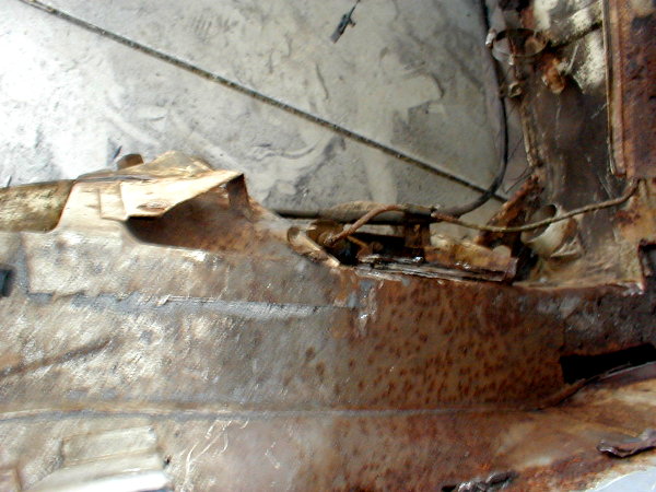

Other nastyness from this side.
Amazingly the other side (drivers side) is solid as a rock.

tdgray   Typical battery tray rust. I had already cut ( in...   Aug 17 2005, 06:33 PM
tdgray   Other nastyness from this side. Amazingly the oth...   Aug 17 2005, 06:35 PM
