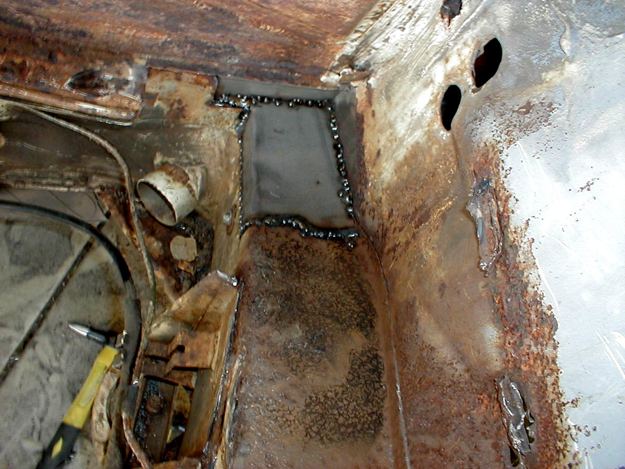

Fabricated and started welding in patch... and no obviously my welding skills have not got any better since the last posting.
I treated the area with Ospho (you can see the black sections starting to form. This will take a few coats. Ospho is a rust converter and a primer. I treated the rest of the engine bay with it later (don't really like to apply this stuff and weld around it).
