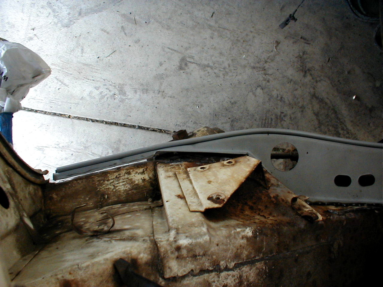

Here is a fitting of the new engine shelf piece.
Notice the rear part.
Although this piece is high in quality from RD, as with all rustoration pieces they will need "customized".
This one was pretty easy. Just a little hand wrenching and a few hammer taps.
Although the end was a bit short, I'm sure that the seal will fill the gap properly
