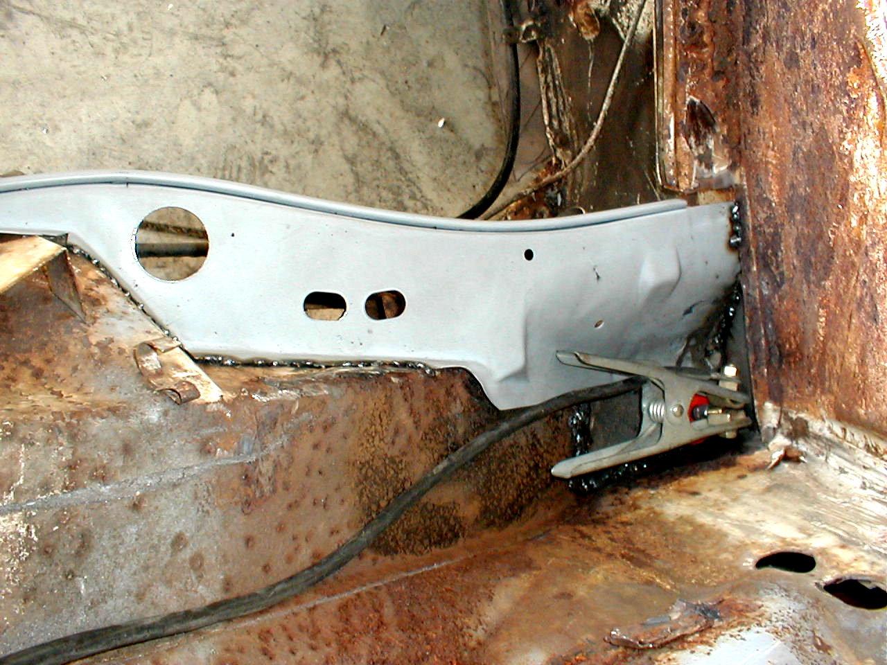

tdgray   Well... my two days off came and went. I spent ha...   Aug 17 2005, 06:28 PM
tdgray   Typical battery tray rust. I had already cut ( in...   Aug 17 2005, 06:33 PM
tdgray   Other nastyness from this side. Amazingly the oth...   Aug 17 2005, 06:35 PM
tdgray   Fabricated and started welding in patch... and no ...   Aug 17 2005, 06:41 PM
tdgray   Sorry for the somewhat " Andy" quality pics. My a...   Aug 17 2005, 06:44 PM
tdgray   Here is a fitting of the new engine shelf piece. ...   Aug 17 2005, 06:49 PM
tdgray   Tacking the rest in. I am such a freaking baby wh...   Aug 17 2005, 06:52 PM
