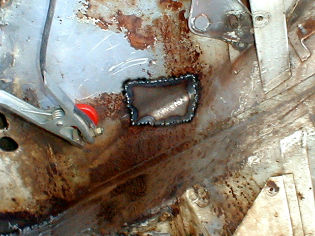

On to the battery damage.
Most of which was caused by taking out.
Pics is slightly deceiving., I saw this pic and said WOW it didn't look that bad. Actually it was. Lot's of grinding. Came out nice and smooth.

tdgray   Typical battery tray rust. I had already cut ( in...   Aug 17 2005, 06:33 PM
tdgray   Other nastyness from this side. Amazingly the oth...   Aug 17 2005, 06:35 PM
tdgray   Fabricated and started welding in patch... and no ...   Aug 17 2005, 06:41 PM
tdgray   Sorry for the somewhat " Andy" quality pics. My a...   Aug 17 2005, 06:44 PM
tdgray   Here is a fitting of the new engine shelf piece. ...   Aug 17 2005, 06:49 PM
tdgray   Tacking the rest in. I am such a freaking baby wh...   Aug 17 2005, 06:52 PM
