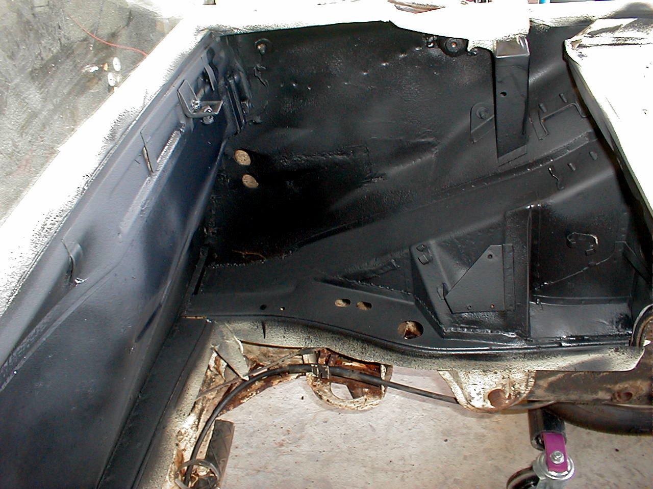

And in my usual style (read: yes I went like hell and forgot to take pics).
I wheeled the car outside and gave the engine bay a degreasing bath with the pressure washer. Let it dry for a couple of hours and then Ospho'd the lving crap out of it.
Got up the next morning and did this.
