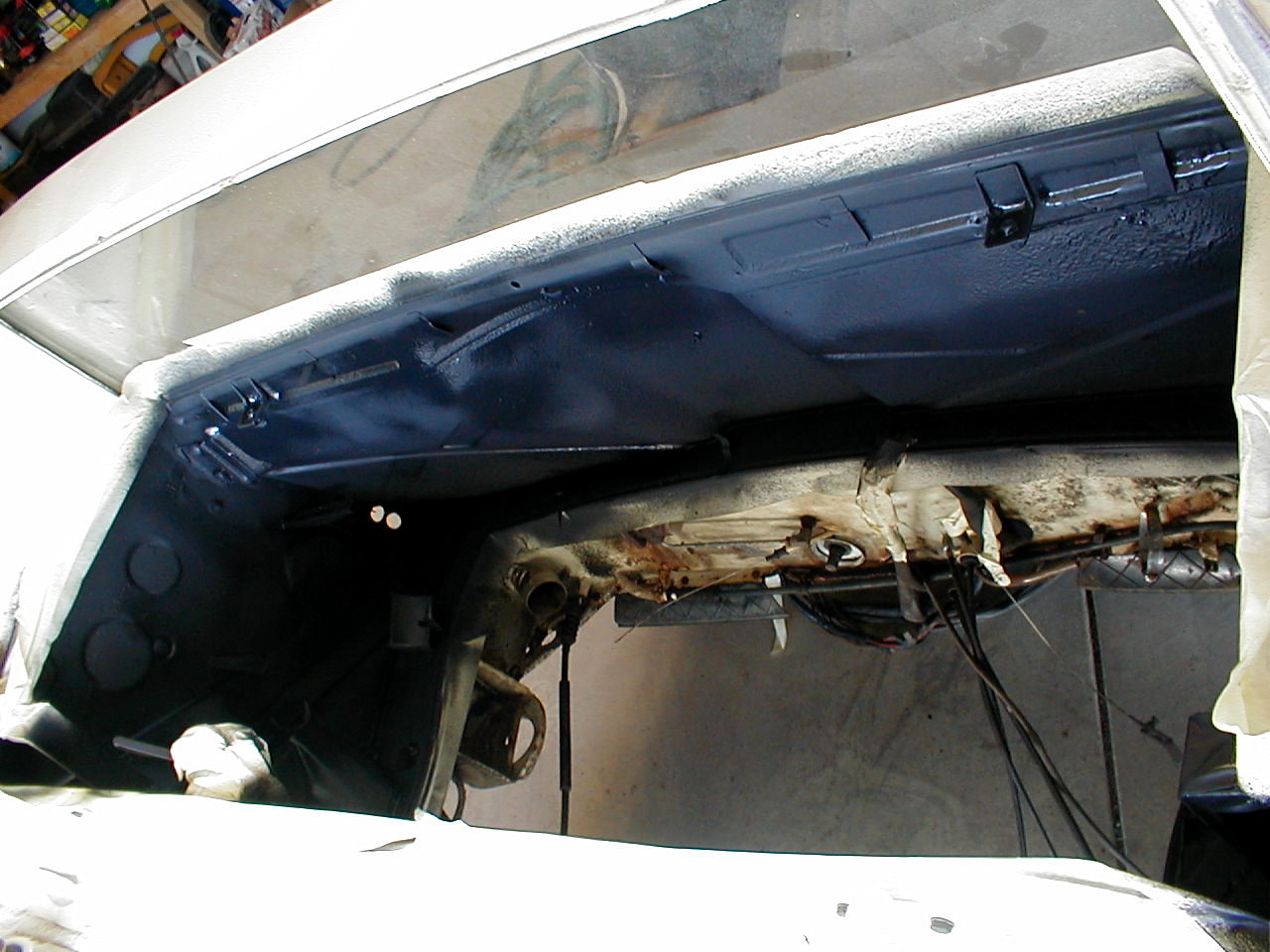

Don't worry... this is only "Rock Guard"
It is basically a textured spray that insulates sound and provides a chip resistant surface.
It is totally paintable. The engine bay will be white just like the rest of the car.
I did realize after I got this on that some of my welds from the previous day looked a little rough... to say the least.
At this point I went and bought an angle die grinder. SHIT if I knew how much better that worked I would have bought one long ago. OH WELL live and learn.
More after the bay is painted... next weekend hopefully.
