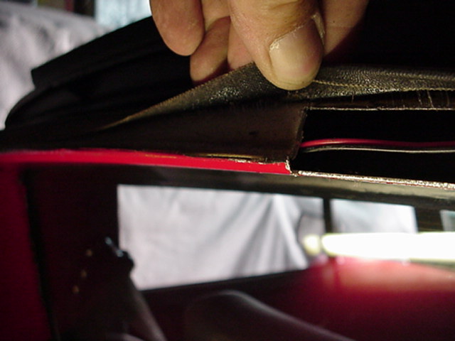

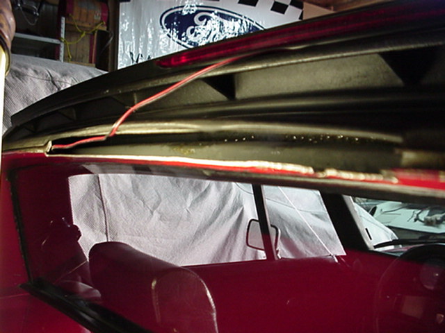

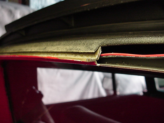

Garland   The trim needs to be cut out of the top 2/3 for th...   Aug 21 2005, 10:41 PM
Garland   This shot shows the trim bar upside down. Notice t...   Aug 21 2005, 10:42 PM
Garland   This is from the back side of the trim. The black ...   Aug 21 2005, 10:43 PM
Garland   Another view of the backside.   Aug 21 2005, 10:43 PM
Garland   The wiring comes out the back of the lamp through ...   Aug 21 2005, 10:44 PM
Garland   Down the sail behind the sail trim,   Aug 21 2005, 10:44 PM
Garland   and between the left grill end piece,   Aug 21 2005, 10:45 PM
Garland   into the trunk. Along the left side wiring harness...   Aug 21 2005, 10:46 PM
Garland   I hope that will help anyone doing this 3rd brake ...   Aug 21 2005, 10:47 PM
