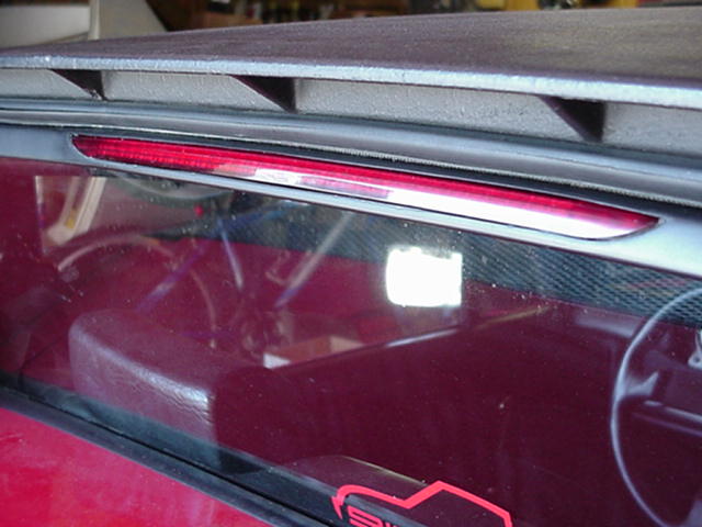

Well can you see it?

The trim needs to be cut out of the top 2/3 for the light to fit into the roll bar, and fit into the trim due to the backside shape of the trim piece. No cutting of the trim is needed other then the hole for the lamp on the face side of the trim. This was also done with a jig saw after drilling a starter hole for the blade to fit through.

Garland   A little closer look.   Apr 9 2005, 10:38 PM
Garland   Wires are inside the stock roll bar. Then behind t...   Apr 9 2005, 10:40 PM
Garland   Cut the hole in the trim to fit the face of the la...   Apr 9 2005, 10:44 PM
Garland   Light on   Apr 9 2005, 10:46 PM
Garland   DOT approved lamp, brightest light on the car.   Apr 9 2005, 10:48 PM
Garland   Top off.   Apr 9 2005, 10:50 PM
Garland   Again flush, almost with trim. Did not want to hav...   Apr 9 2005, 10:53 PM
Garland   This picture just was cool.   Apr 9 2005, 10:54 PM

Garland   The trim needs to be cut out of the top 2/3 for th...   Aug 21 2005, 10:41 PM
Garland   This shot shows the trim bar upside down. Notice t...   Aug 21 2005, 10:42 PM
Garland   This is from the back side of the trim. The black ...   Aug 21 2005, 10:43 PM
Garland   Another view of the backside.   Aug 21 2005, 10:43 PM
Garland   The wiring comes out the back of the lamp through ...   Aug 21 2005, 10:44 PM
Garland   Down the sail behind the sail trim,   Aug 21 2005, 10:44 PM
Garland   and between the left grill end piece,   Aug 21 2005, 10:45 PM
Garland   into the trunk. Along the left side wiring harness...   Aug 21 2005, 10:46 PM
Garland   I hope that will help anyone doing this 3rd brake ...   Aug 21 2005, 10:47 PM
SpecialK   NICELY DONE!! Looks like it should have b...   Aug 22 2005, 08:33 PM
Garland   A few more shots.   Aug 22 2005, 09:18 PM
Garland   Parking lamps are on also.   Aug 22 2005, 09:22 PM
