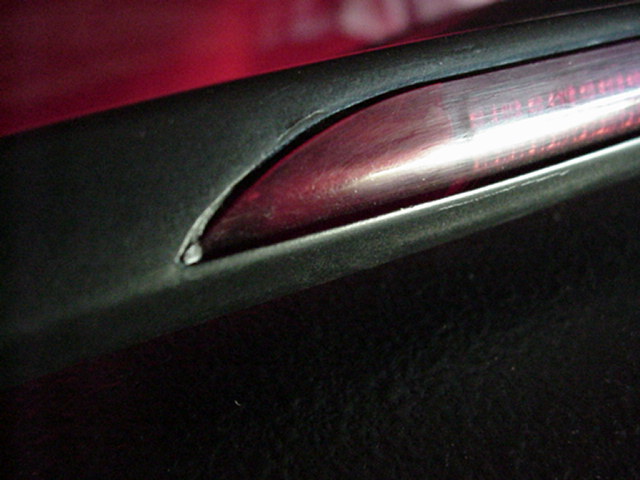

This shot shows the trim bar upside down. Notice the curvature of the cut. Slightly smaller then the light so no gap shows. This also holds the lamp
from falling out. Nothing other then the trim holds the lamp in place.

Garland   The trim needs to be cut out of the top 2/3 for th...   Aug 21 2005, 10:41 PM
Garland   This shot shows the trim bar upside down. Notice t...   Aug 21 2005, 10:42 PM
Garland   This is from the back side of the trim. The black ...   Aug 21 2005, 10:43 PM
Garland   Another view of the backside.   Aug 21 2005, 10:43 PM
Garland   The wiring comes out the back of the lamp through ...   Aug 21 2005, 10:44 PM
Garland   Down the sail behind the sail trim,   Aug 21 2005, 10:44 PM
Garland   and between the left grill end piece,   Aug 21 2005, 10:45 PM
Garland   into the trunk. Along the left side wiring harness...   Aug 21 2005, 10:46 PM
Garland   I hope that will help anyone doing this 3rd brake ...   Aug 21 2005, 10:47 PM
