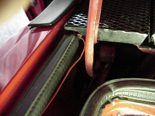

Garland   The wiring comes out the back of the lamp through ...   Aug 21 2005, 10:44 PM
Garland   Down the sail behind the sail trim,   Aug 21 2005, 10:44 PM
Garland   and between the left grill end piece,   Aug 21 2005, 10:45 PM
Garland   into the trunk. Along the left side wiring harness...   Aug 21 2005, 10:46 PM
Garland   I hope that will help anyone doing this 3rd brake ...   Aug 21 2005, 10:47 PM
