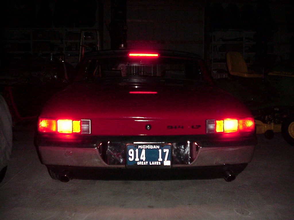

Well can you see it?

Parking lamps are on also.

Garland   Wires are inside the stock roll bar. Then behind t...   Apr 9 2005, 10:40 PM
Garland   Cut the hole in the trim to fit the face of the la...   Apr 9 2005, 10:44 PM

Garland   DOT approved lamp, brightest light on the car.   Apr 9 2005, 10:48 PM

Garland   Again flush, almost with trim. Did not want to hav...   Apr 9 2005, 10:53 PM

Garland   The trim needs to be cut out of the top 2/3 for th...   Aug 21 2005, 10:41 PM
Garland   This shot shows the trim bar upside down. Notice t...   Aug 21 2005, 10:42 PM
Garland   This is from the back side of the trim. The black ...   Aug 21 2005, 10:43 PM
Garland   Another view of the backside.   Aug 21 2005, 10:43 PM
Garland   The wiring comes out the back of the lamp through ...   Aug 21 2005, 10:44 PM
Garland   Down the sail behind the sail trim,   Aug 21 2005, 10:44 PM
Garland   and between the left grill end piece,   Aug 21 2005, 10:45 PM
Garland   into the trunk. Along the left side wiring harness...   Aug 21 2005, 10:46 PM
Garland   I hope that will help anyone doing this 3rd brake ...   Aug 21 2005, 10:47 PM

Garland   A few more shots.   Aug 22 2005, 09:18 PM
Garland   Parking lamps are on also.   Aug 22 2005, 09:22 PM

Garland   I’ve been wanting to extend the third brake lamp...   Jul 23 2019, 05:59 PM
Garland   More, and it’s very bright.   Jul 23 2019, 06:03 PM

Garland   Are used a router bit, in a drill press. It’s a...   Jul 23 2019, 09:42 PM
