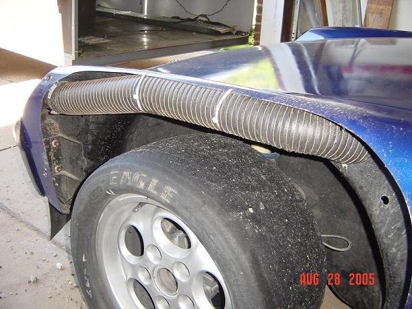

In another thread some of us discussed a variety of methods to get fresh, cool air to the engine to assist in engine cooling.
I ran this setup at M-O last weekend and my CHTs dropped to under 400 degrees for the first time since my engine rebuild. Before these ducts, I could only run 1 or 2 hot laps before my CHTs got too hot. Now, I can run 20 laps at M-O and the temps stay under 400 degrees.
2-3" ducts from each turn signal opening.

Another view of the hose running in the front fender:

Headrage   How do you get it all the way to the engine compar...   Aug 28 2005, 09:17 AM
groot   Passenger compartment.... maybe not the best optio...   Aug 28 2005, 09:19 AM
