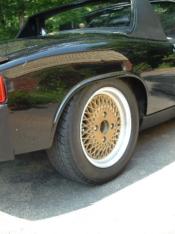

According to "Tech Tips 700", page 38, item #265, I may be suffering from weak spring syndrome! I have attached photos showing the left rear, right rear, right rear fender clearance and a side view to show front to rear difference.
As near as I can tell, the springs currently on the car have two green marks. If I need new springs, what do you people recommend?

Mueller   one thing to consider is that "as delivered" the 9...   Aug 28 2005, 05:29 PM
Tobra   Stock super beetles are set up higher in the front...   Aug 28 2005, 06:38 PM

JOHNMAN   Due to the fact that there is no published factory...   Aug 28 2005, 11:18 PM
Andyrew   double green marks where what.. 105 lbs? if that? ...   Aug 29 2005, 01:39 AM
redshift   Lots more camber on the right though... ...   Aug 30 2005, 04:17 PM
