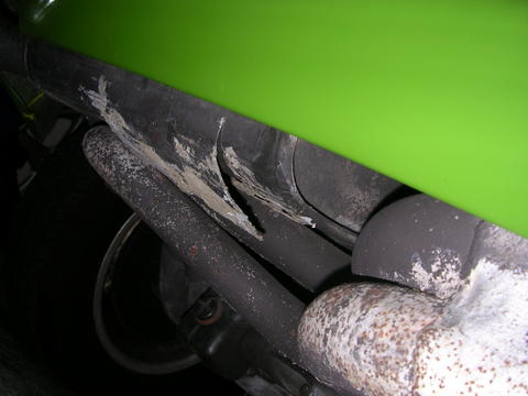

Today, my wife and I go out, and the car is LOUD as hell..... gargling and backfiring all over the place. I crawl underneath it....... low and behold, the muffler has almost literally exploded.

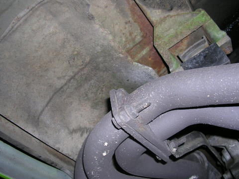

Obviously my car runs good with the exhaust thats on it..... so I need to stick with something exactly like it, or very close........... but I have no idea which exhaust it is.
I took some quick pics...... I know some of you smart guys will know exactly what it is...... plus you can see how my muffler exploded (IMG:http://www.914world.com/bbs2/html/emoticons/biggrin.gif)

Aaron Cox   BURSCH   Sep 2 2005, 10:12 PM
ninefourteener   Who has the best prices on a Bursch exhaust?? Pel...   Sep 2 2005, 10:15 PM
Maltese Falcon   Bursch, mfg by Horsepower Engineering, you may be ...   Sep 2 2005, 10:19 PM

Cap'n Krusty   1.7/1.8 heat exchangers. Get a muffler shop to we...   Sep 2 2005, 11:02 PM
Travis Neff   I agree with the cap'n, get a new muffler and ...   Sep 2 2005, 11:06 PM
rhodyguy   check out www.edelbrock.com, look for the SDT muff...   Sep 3 2005, 08:34 AM
Brando   Forget a new muffler... weld on a $10 cherry ...   Sep 3 2005, 11:06 AM

rhodyguy   if you followed the hanging flap all the way to th...   Sep 3 2005, 06:01 PM
Tom Perso   The amount of time that it takes to split a cheap ...   Sep 3 2005, 08:02 PM
