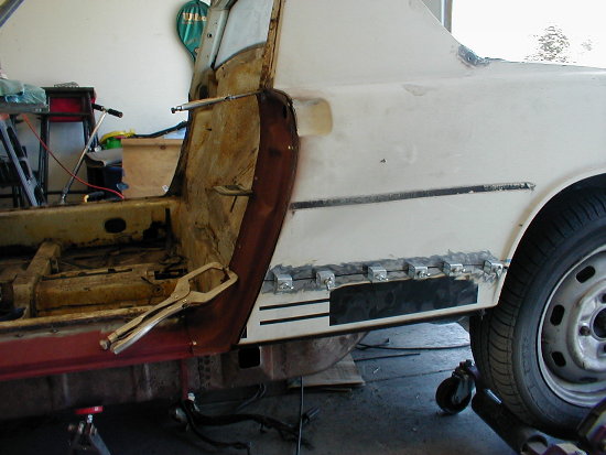

Here is final fitting before finish welding. Fender is original. Makes life much easier. (IMG:http://www.914world.com/bbs2/html/emoticons/wacko.gif)

tdgray   Here is final fitting before finish welding. Fende...   Sep 6 2005, 07:12 PM
