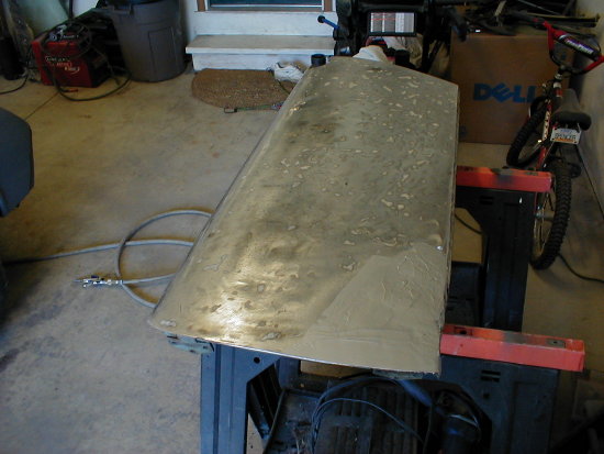

Here is the really UGLY (IMG:http://www.914world.com/bbs2/html/emoticons/barf.gif) ... my eyes...my eyes.
This is actually a donor door I got from Doug H. Believe or not my orginal was worse.
That is a pretty deep smack in the door. Some A-hole had filled it with plastic filler.
The rest of the door is pretty straight. I have no doubt that the All Metal will be just fine. Shouldn't take more than three coats to egt it smoothed out.
