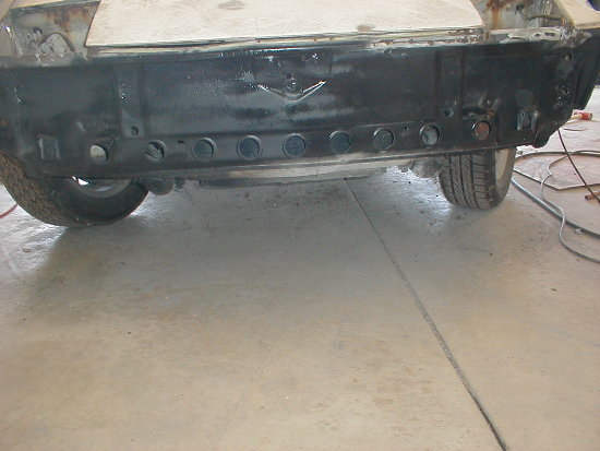

tdgray   First task at hand was to cut the trunk and valanc...   Aug 10 2005, 09:52 AM
tdgray   All buttoned up... still needs finishing and rear ...   Aug 10 2005, 09:53 AM
