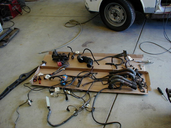

The parts boxes grow (IMG:http://www.914world.com/bbs2/html/emoticons/ohmy.gif)

tdgray   The parts boxes grow http://www.91...   Sep 6 2005, 07:37 PM
