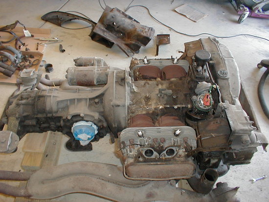

tdgray   Next Task... Drop the engine. Easy job took my br...   Aug 10 2005, 09:54 AM
tdgray   Damn that engine looks big when it is not in the c...   Aug 10 2005, 09:55 AM
