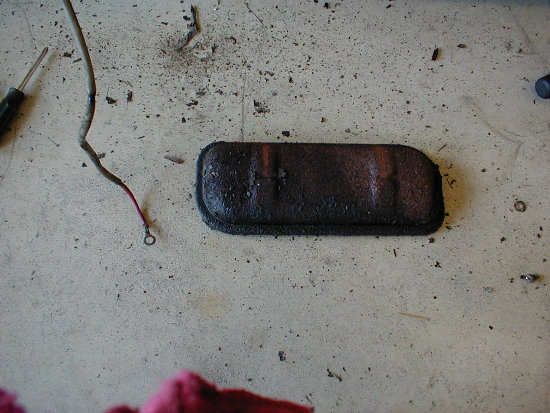

You would think with a valve cover this bad... the damage inside would be VERY BAD

tdgray   You would think with a valve cover this bad... the...   Sep 6 2005, 07:40 PM
tdgray   Not too bad... in definite need of adjustment. but...   Sep 6 2005, 07:41 PM
