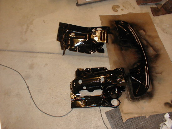

Tonight's progress
They could be better but, hey it's just a driver. The rest of the tin will be done this week.
I ordered some parts this AM. Maybe just maybe if all goes right the engine can go back in next week.
Still have to decide what to do about the battery tray and paint the engine bay.

tdgray   Tonight's progress They could be better but, ...   Sep 6 2005, 07:46 PM
