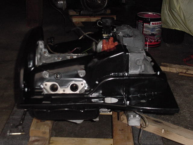

rhodyguy   too black. way too black. k   Sep 16 2005, 08:35 PM
rhodyguy   better. much better. k   Sep 16 2005, 08:43 PM
rhodyguy   still a few stray lines to install. new fan belt. ...   Sep 16 2005, 08:44 PM
rhodyguy   Cerama-Chrome. i put the gear lube in the trans to...   Sep 16 2005, 08:47 PM
rhodyguy   i should be mating the engine and the trans on sa...   Sep 16 2005, 08:49 PM
sixnotfour   Is that really Cerama-Chrome, If it is it looks wa...   Sep 16 2005, 08:55 PM
rdauenhauer   I was wondering the same thing P.C. did the Cerma-...   Sep 16 2005, 09:05 PM
rhodyguy   i took the items in for the Cerama-Chrome yest. ho...   Sep 16 2005, 09:12 PM

rhodyguy   the engine is going in this car. k   Sep 16 2005, 09:27 PM

rhodyguy   5.5x15. 195/60 tires. tons of room. the chrome tri...   Sep 16 2005, 09:53 PM
