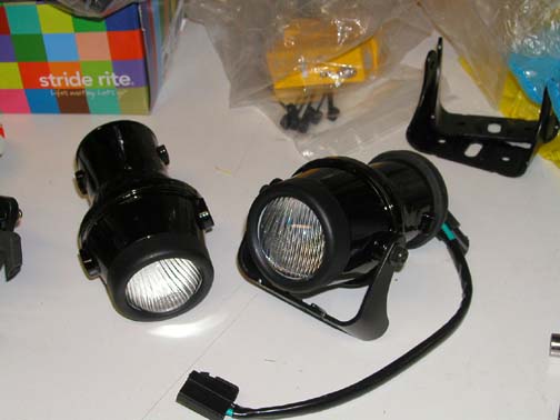

QUOTE (Andyrew @ Sep 14 2005, 06:45 PM)
Keep us posted.
Im deciding on my car. (fg wont hold that big module but somthing could be welded from the side to hold it...)
Andrwe
It already has a U bracket, all you'd need is an L bracket on the body to mount it...
These are the fog versions that I'll mount in the bumper. Slightly different body and lense but the brackets are the same...
