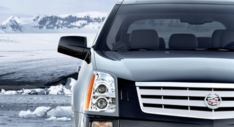

Hey Jon, we think alike... (IMG:http://www.914world.com/bbs2/html/emoticons/blink.gif)
I had the same thought of cutting down Celica assemblies but they are still quite larger ~4" for the signal pod. Plus the profile didn't match.
Just like the side glass, I stared at alot of car's headlights in parking lots (IMG:http://www.914world.com/bbs2/html/emoticons/laugh.gif)
I liked the stacked lights on Caddy SRX but they were also too large.
