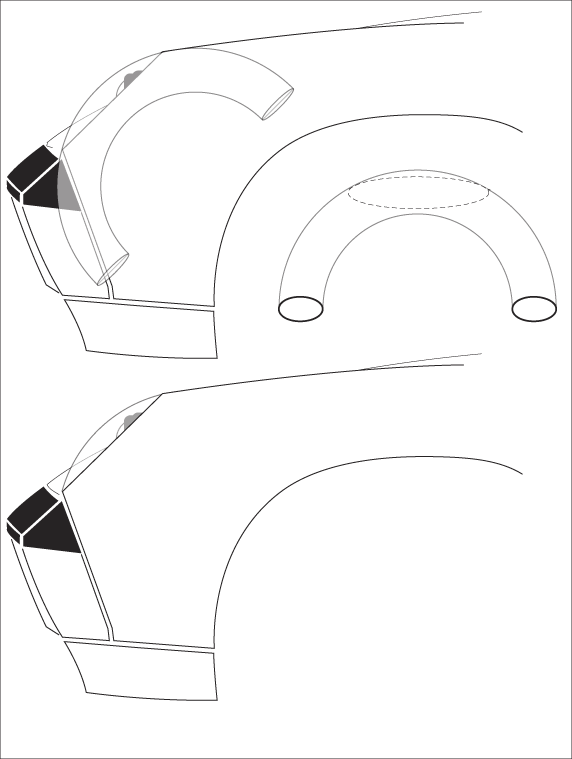

Polycarbonate, aka "Lexan" is probably the easiest answer.
Low refraction, great clarity, (88% @ .125" thick), UV stable, easily glued, can be heat formed at around 350°F, soft enough to give without breaking.
It occured to me that the lense shape is roughly elliptical and an ellipse can be sliced out of a curved tube. I don't have the ideal diameter figured out yet, but I would guess around 3.5" OD, .125" wall Lexan tube. Cast tubing, not extruded.
Also, a lense that is taller or "rounder" (not as flat as the stock one) would achieve three things:
1. Less of an angle is presented to the light beam = less refraction.
2. Increased distance from the lamp = less chance of heat distortion.
3. Stronger, more spherical shape.
