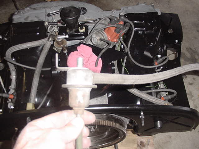

rhodyguy   how do i get these f.l. ends off the injectors? i...   Aug 31 2005, 03:48 PM
Eric Taylor   If you lossen the clamp on the hose, you can fanag...   Aug 31 2005, 04:56 PM
rhodyguy   oh no eric. they will be removed and new hose and ...   Aug 31 2005, 05:30 PM
rhodyguy   it just seems as though it would be so much easier...   Aug 31 2005, 05:35 PM
Travis Neff   Nothing on the threads at all even antiseize, it...   Aug 31 2005, 07:04 PM

rhodyguy   sprayed the engine down with full strength Oil Eat...   Sep 2 2005, 04:04 PM
rhodyguy   rinse and repeat. damn near too bright when the su...   Sep 2 2005, 04:05 PM
rhodyguy   BONUS!!! ready to pull a few items off...   Sep 2 2005, 04:09 PM

rhodyguy   cleaned and powder coated. begin assembly tomorrow...   Sep 13 2005, 05:25 PM

rhodyguy   busy day. adj valves, r&r front inboard engine mou...   Sep 14 2005, 08:04 PM

rhodyguy   still a few stray lines to install. new fan belt. ...   Sep 16 2005, 08:44 PM
rhodyguy   Cerama-Chrome. i put the gear lube in the trans to...   Sep 16 2005, 08:47 PM
rhodyguy   i should be mating the engine and the trans on sa...   Sep 16 2005, 08:49 PM
