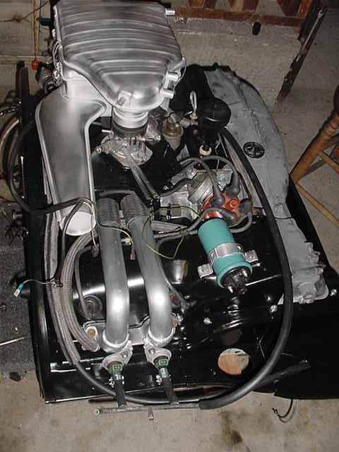

getting started. try to tidy it up and put a bit of shine on it.

still a few stray lines to install. new fan belt.

rhodyguy   how do i get these f.l. ends off the injectors? i...   Aug 31 2005, 03:48 PM
Eric Taylor   If you lossen the clamp on the hose, you can fanag...   Aug 31 2005, 04:56 PM
rhodyguy   oh no eric. they will be removed and new hose and ...   Aug 31 2005, 05:30 PM
rhodyguy   it just seems as though it would be so much easier...   Aug 31 2005, 05:35 PM
Travis Neff   Nothing on the threads at all even antiseize, it...   Aug 31 2005, 07:04 PM
rhodyguy   this engine cleaned up pretty easily for the initi...   Aug 31 2005, 07:35 PM
rhodyguy   this oily stuff is pretty superficial. the oil coo...   Aug 31 2005, 07:37 PM
pete-stevers   looks good Kevin...if only you could have waited a...   Aug 31 2005, 07:49 PM
rhodyguy   asdf   Aug 31 2005, 08:18 PM
MarkV   Mine is older. http://www.9...   Aug 31 2005, 08:26 PM
rhodyguy   sprayed the engine down with full strength Oil Eat...   Sep 2 2005, 04:04 PM
rhodyguy   rinse and repeat. damn near too bright when the su...   Sep 2 2005, 04:05 PM
rhodyguy   BONUS!!! ready to pull a few items off...   Sep 2 2005, 04:09 PM
rhodyguy   well... while i'm in there. k   Sep 3 2005, 06:22 PM
rhodyguy   cleaned and powder coated. begin assembly tomorrow...   Sep 13 2005, 05:25 PM

rhodyguy   jon, some came off of the engine, some came out of...   Sep 14 2005, 05:47 AM

rhodyguy   will adjust the valves, temp put on the flywheel, ...   Sep 14 2005, 08:30 AM
goose2   Nice work Kevin...curious about "oil eater" having...   Sep 14 2005, 08:50 AM
rhodyguy   randy, i buy it at Costco. Oil Eater is the brand ...   Sep 14 2005, 09:13 AM
rhodyguy   Ken's also does ceramic with thermal barrier p...   Sep 14 2005, 09:38 AM
goose2     Sep 14 2005, 09:59 AM
rhodyguy   randy, pm to be sent. k   Sep 14 2005, 10:03 AM
rhodyguy   busy day. adj valves, r&r front inboard engine mou...   Sep 14 2005, 08:04 PM

rhodyguy   too black. way too black. k   Sep 16 2005, 08:35 PM
rhodyguy   better. much better. k   Sep 16 2005, 08:43 PM
rhodyguy   Cerama-Chrome. i put the gear lube in the trans to...   Sep 16 2005, 08:47 PM
rhodyguy   i should be mating the engine and the trans on sa...   Sep 16 2005, 08:49 PM
sixnotfour   Is that really Cerama-Chrome, If it is it looks wa...   Sep 16 2005, 08:55 PM
rdauenhauer   I was wondering the same thing P.C. did the Cerma-...   Sep 16 2005, 09:05 PM
rhodyguy   i took the items in for the Cerama-Chrome yest. ho...   Sep 16 2005, 09:12 PM

rhodyguy   the engine is going in this car. k   Sep 16 2005, 09:27 PM

rhodyguy   5.5x15. 195/60 tires. tons of room. the chrome tri...   Sep 16 2005, 09:53 PM

rhodyguy   don't forget the flywheel o-ring. DOH!...   Sep 18 2005, 07:47 AM

greenie   Hey Rhody Guy, Just a heads up..... after I go...   Sep 18 2005, 09:05 AM
rhodyguy   did you replace both of the seals on each injector...   Sep 18 2005, 09:20 AM
greenie   Rhody Guy, Yes I bought new seals , the little o...   Sep 18 2005, 09:35 AM
rhodyguy   progress on this one tho. final wiring harness to ...   Sep 22 2005, 07:10 AM
