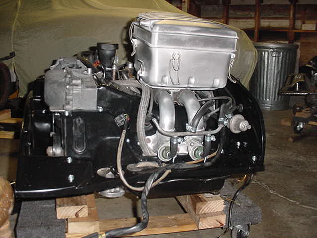

getting started. try to tidy it up and put a bit of shine on it.

Cerama-Chrome. i put the gear lube in the trans too.

rhodyguy   sprayed the engine down with full strength Oil Eat...   Sep 2 2005, 04:04 PM
rhodyguy   rinse and repeat. damn near too bright when the su...   Sep 2 2005, 04:05 PM
rhodyguy   BONUS!!! ready to pull a few items off...   Sep 2 2005, 04:09 PM
rhodyguy   well... while i'm in there. k   Sep 3 2005, 06:22 PM
rhodyguy   cleaned and powder coated. begin assembly tomorrow...   Sep 13 2005, 05:25 PM

rhodyguy   will adjust the valves, temp put on the flywheel, ...   Sep 14 2005, 08:30 AM

rhodyguy   busy day. adj valves, r&r front inboard engine mou...   Sep 14 2005, 08:04 PM

rhodyguy   too black. way too black. k   Sep 16 2005, 08:35 PM
rhodyguy   better. much better. k   Sep 16 2005, 08:43 PM
rhodyguy   still a few stray lines to install. new fan belt. ...   Sep 16 2005, 08:44 PM
rhodyguy   i should be mating the engine and the trans on sa...   Sep 16 2005, 08:49 PM

rhodyguy   i took the items in for the Cerama-Chrome yest. ho...   Sep 16 2005, 09:12 PM

rhodyguy   5.5x15. 195/60 tires. tons of room. the chrome tri...   Sep 16 2005, 09:53 PM

rhodyguy   progress on this one tho. final wiring harness to ...   Sep 22 2005, 07:10 AM
