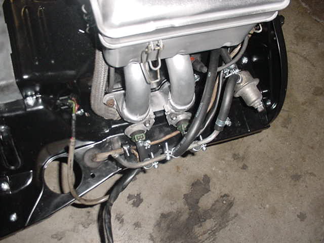

rhodyguy   progress on this one tho. final wiring harness to ...   Sep 22 2005, 07:10 AM
